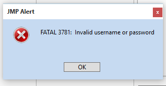

If the UI is presented, and the user is interacting with it.. all of the sudden these errors are not going to the log, but instead are displayed interactively..image001.pngimage001.png

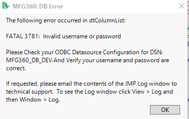

Which of ‘course  results in further errors, because we couldn’t trap the error from the log like we have for all our other scripts…image002.pngimage002.png

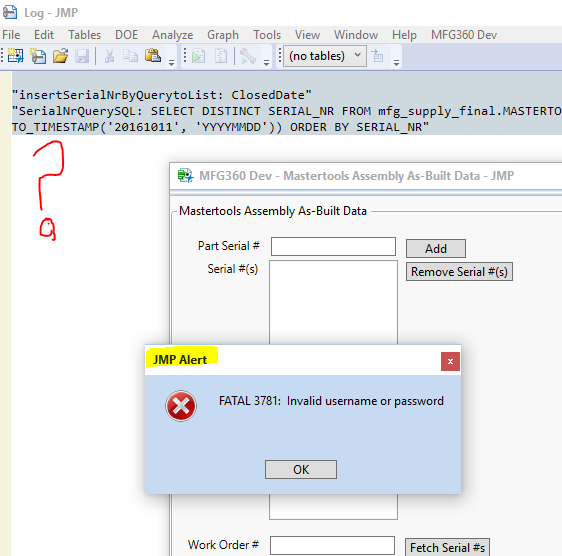

As I test, I added a DB call prior to the UI appearing (via new Window())
And sure, enough, the error goes to  the log, and I can  trap it….image003.pngimage003.png

I just performed a test on one of our other scripts based on what I am figuring out… and I DO see the same behavior….
Any DB Calls AFTER the UI is up and running, seem to present interactive JMP Alerts, but nothing is going to the log file..??
This sort of breaks my error handling….. and I’ll have to add more validation tests to check the DataTable returned I guess….??
Unless there is a way to force these errors to go to the log so I can provide more user friendly error dialogs…image005.pngimage005.png
