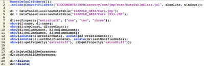

Usage of the fields for DataTableClass instances would look like:
For such a simple example, there would no reason to use the OO constructs. However, if you were to consider a case where you wanted to manage collections of tables, enable users and external systems to add comments and other attributes, pass these collections around, process and respond to given events, plan for future expansion and extension, establish a "contract" by which others can easily consume these tables, etc. Then, using OO constructs such as these are very beneficial.

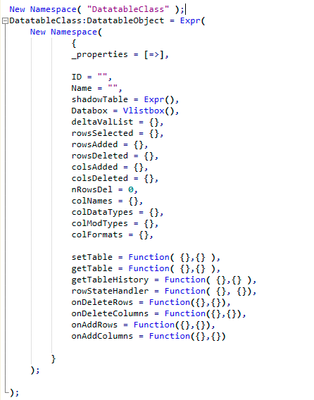

So, a possible "constructor" for the DatatableObject could look like, where member variables and functions are declared. (note the Expr( New Namespace() ).
The idea behind declaring the object this way, is not only establish a replicable entity, but also allows one to clearly see the functions and expression names that will become usable once they are fully defined.

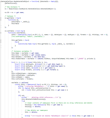

My version of the NewDatatableObject (partial listing). Here is where the member functions are actually defined:
So for example, we create 2 separate instances of DatatableObject:

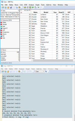

These tables now have "extended" properties built-in. In this example, some table actions are tracked, such as detecting row selection and Column/Row deletions.
12620_Screen Shot 2016-08-25 at 1.07.03 PM.png12613_Screen Shot 2016-08-25 at 1.06.06 PM.png
