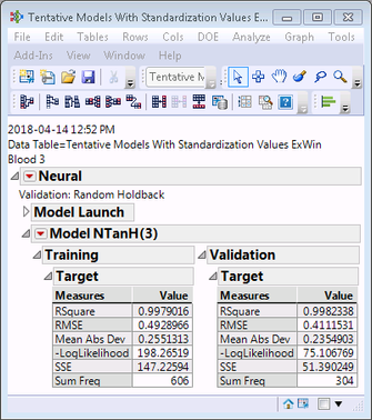

I am trying to run a script that automates screening the eight different penalty modes in Neural Network and outputting the results into the current table. I have been troubleshooting why I am not getting different results from the different Fits in the script. This led me to look at the results for each individual penalty mode when the model was set up from the Neural Menu vs the script. The script was made by saving the analysis script to the Data Table and then running it. So the results should be identical.
Set up of model from Analyze>Predictive Modeling>NeuralSet up of model from Analyze>Predictive Modeling>Neural
Initial run of modelInitial run of modelRedo Analysis #1Redo Analysis #1Redo Analysis #2Redo Analysis #2
If I relaunch the model and select all the same settings, I get the same result as the Initial Result above. If I run from a script, I get the same results as from Redo Analysis.

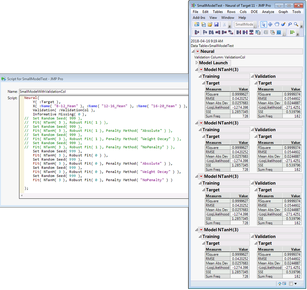

jwalk
Level III
Re: Not getting same results in neural network run from menu vs run from script.

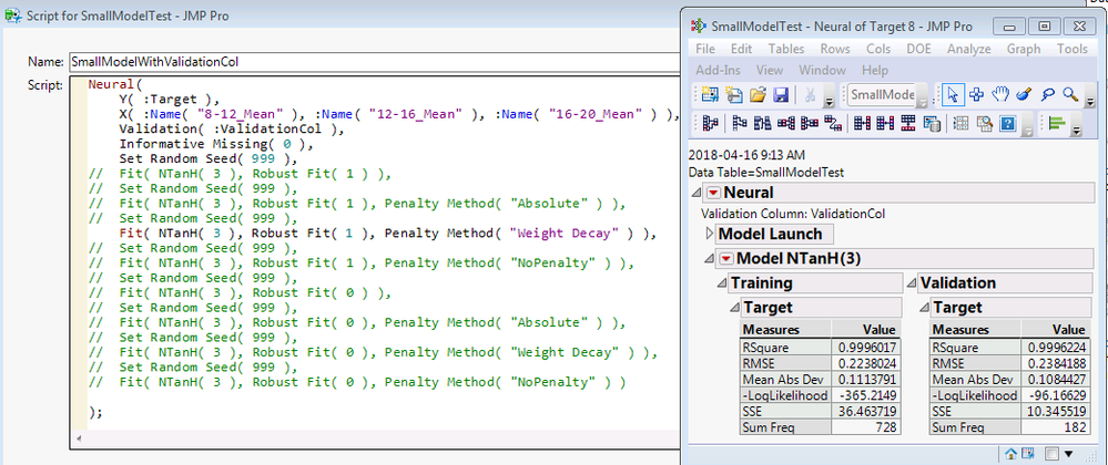

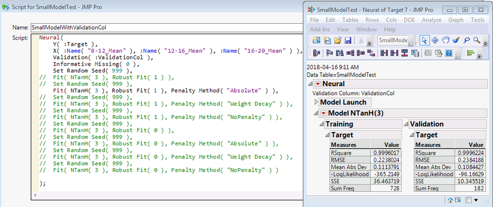

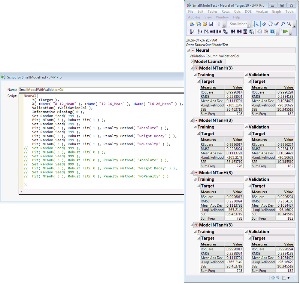

Having a validation column and setting the random seed does not fix the problem. I made a Random KFold(5) validation column (ValidationCol) and used it in the code below. I have also checked using a Holdback validation column and the behaviour is the same.
First, if you comment out the Fit() from top to bottom, you see that the second (Absolute), third (WeightDecay) and Fourth (NoPenalty) penalty modes give the same result as the first (Squared). Second, if you reset the Random Seed to 999 between Fits the results are the same for all the Robust Models and the same for all Non-robust models. The Set Random Seed function must be doing something (reset?) to the model parameters at runtime.
My concern is that the only way to get reproducability is by using a seed, but doing so seems to 'fix' the penalty mode.
Neural(
	Y( :Target ),
	X( :Name( "8-12_Mean" ), :Name( "12-16_Mean" ), :Name( "16-20_Mean" ) ),
	Validation( :ValidationCol ),
	Informative Missing( 0 ),
	Set Random Seed( 999 ),
	Fit( NTanH( 3 ), Robust Fit( 1 ) ),
	Fit( NTanH( 3 ), Robust Fit( 1 ), Penalty Method( "Absolute" ) ),
	Fit( NTanH( 3 ), Robust Fit( 1 ), Penalty Method( "Weight Decay" ) ),
	Fit( NTanH( 3 ), Robust Fit( 1 ), Penalty Method( "NoPenalty" ) ),
	Fit( NTanH( 3 ), Robust Fit( 0 ) ),
	Fit( NTanH( 3 ), Robust Fit( 0 ), Penalty Method( "Absolute" ) ),
	Fit( NTanH( 3 ), Robust Fit( 0 ), Penalty Method( "Weight Decay" ) ),
	Fit( NTanH( 3 ), Robust Fit( 0 ), Penalty Method( "NoPenalty" ) )
 Robust SquaredRobust Squared
Robust AbsoluteRobust Absolute
Robust Weight DecayRobust Weight Decay
Robust No PenaltyRobust No Penalty
All Robust, reset seed for each fitAll Robust, reset seed for each fit
All, non-robust, reset seed for each fitAll, non-robust, reset seed for each fit
