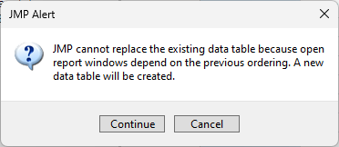

I have a window with a dynamic data filter. The filter is used to distill a table down before going to an external python function for post processing. The filter dynamically updates well when deleting rows. However, if I sort the rows in my data table by certain column values it seems like the table is disconnected /non-communicative with the window since changing the filter no longer triggers a python call. Even if I undo the sorting it still persists. I have a feeling that this is due to the fact that sorting function replaces the current data table and it may be necessary to somehow resync the filter.

jthi
Re: Non-communicative data filter after sorting rows
Data filter will get "disconnected" from the table. If you just create a global data filter to a table and then try to sort it, JMP will give you following message

There might be some ways around this, but implementation will depend on your use case.

Deleting rows works fine, but many other changes to the data table aren’t allowed when reports are open or when a linked subset exists. To be honest, this is quite unexpected for JMP "19" — it feels like 199x.
JMP is already powerful—but being able to freely modify a data table even when reports or linked subsets exist would be a huge productivity boost.
