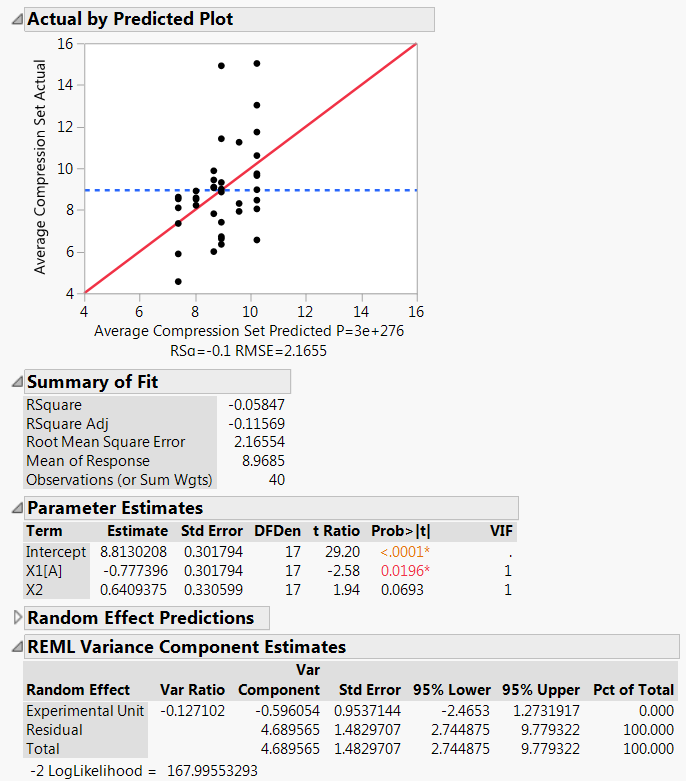

Your description is correct in that I have a random effect with a negative estimate, here is a screen shot (should have included this in the original post).
Mixed Model Output with negative R2Mixed Model Output with negative R2
I was wondering about the statistical details for R2 for mixed models (which I can't find in the link you provided). Based on a quick internet search it looks like there is more than one method to calculate R2 for mixed models.

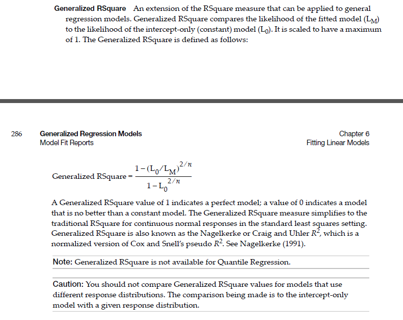

Is it reporting the Generalized RSquare as described in the Mixed Model Personality (JMP Pro only, which I don't have)? This excerpt is from the JMP Fitting Linear Models Book under the Help menu. It looks like this would be reasonable although I don't get a negative R2 when I try this calculation:
