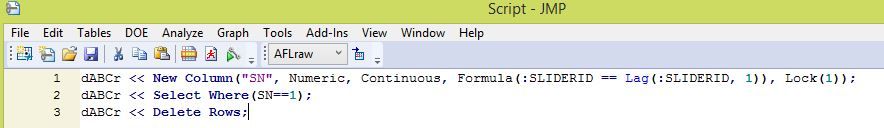

What is is the expected output of the following code?

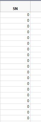

And the new columns just looks like this:

Re: Need help for using Lag function
Your formula is missing an if statement. It should be something like
Formula(If(:sliderID == lag(:sliderID,1),1,0))
I would recommend you get all the steps working by using the menus and mouse clicks before trying to script it.
txnelson
Your formula
     :SliderID == Lag(:SiiderID, 1 )
is a boolean operation.  When the current rows value of SliderID is equal to the previous row's value os SliderID, "Lag(:SliderID, 1)", the value of the comparison will be "True" and therefore it will return a numeric value of 1.  If the comparison of the current row's value of SliderID is not equal to the previous row's value of SliderID, the returned value will be a 0.
@stephen_pearson modification of turning the formula into an "If" clause will result in the same values.
The error that is listed out, is a response to the line
     dABCR << Delete Rows;
and it is being returned, because no rows had been selected as a result of the line
     dABCR << Select Where(SN == 1);
The only correction to this line would be to scope the column reference by placing a ":" in front of SN
     dABCR << Select Where(:SN==1);
Jim

Craige_Hales
Looking at the data, I don't see any repeated SliderID values, so it might be working correctly. You might use
try(dABCE<<DeleteRows)
to catch and ignore the error when there is nothing to delete.
edit: well, not try, if it isn't throwing an error. Maybe this.
Craige
