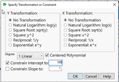

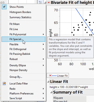

In the Fit Y - by - X / Bivariate Platform there is also an option to set the intercept to a fixed value:
Constrain intercept to

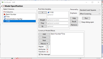

@Tohar , so it sounds like you have an ANCOVA model (one categorical factor C, and one continuous X) and you want to regress Y on these.  Define Y100 = Y-100.  then use Y100 as your response. then the only effect in your model will be C*X, with no intercept. See pic below. Also, in the red triangle pull down menu deselect "Center Polynomials".

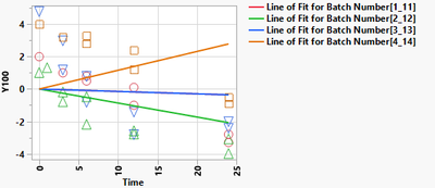

Run this and get the following: And remember Y100 is Y-100. So, when Y100=0, Y=100. You can then get creative with Save Prediction Formula/Graph Builder/etc to get the Y axis back to the raw scale (shift it back up by 100).

I am not about the result I got; the lines cross the Y axis in (0,0) - see attached.
My goal is to check if there is a difference in rate (ie slope) between the two treatment groups. It is not necessary to check whether there is a difference in the intercept, I want to set it both in the model and in the presentation graph at (0,100).

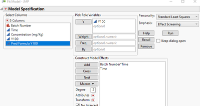

Re: Multiple regression with dummy variables
@Tohar . On second thought, use the same model with the interaction (as I said) and Days From Start.(see below). Then assess the equivalence of slopes via the p-value for the interaction parameter estimate. Adding the extra term will give more flexibility wrt the slope estimates (doesn't force slope1 = -slope2).
