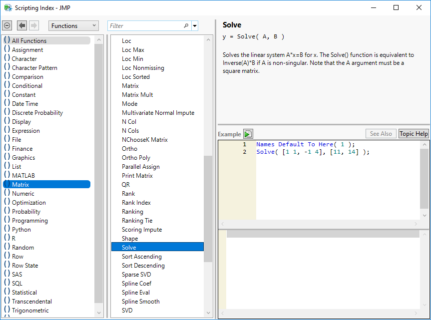

I have 11 equations with 11 unknowns.  I need to know if JMP can solve all these equations for each row?  So day 1, I need to solve these equations.  For day 2 I need to solve these equations only using day 2 information.
I know how to solve for one equation in JMP, but can JMP solve multiple equations.

Assuming that these are linear equations, you can use the Solve() function in the JMP scripting language. It looks like this:
You can look up the functions to create the matrix in your code or you could enter the values in a JMP data table and send the Get As Matrix message to the data table.

Thanks.  I will try and use this and see if it works.  I assume I can do 11 equations at once and tie it back to the table?  I am new on JMP scripting.

Is there anything that can give me more guidance of how to put 11 equations into scripting and tie some of the variables back to the columns in JMP?
