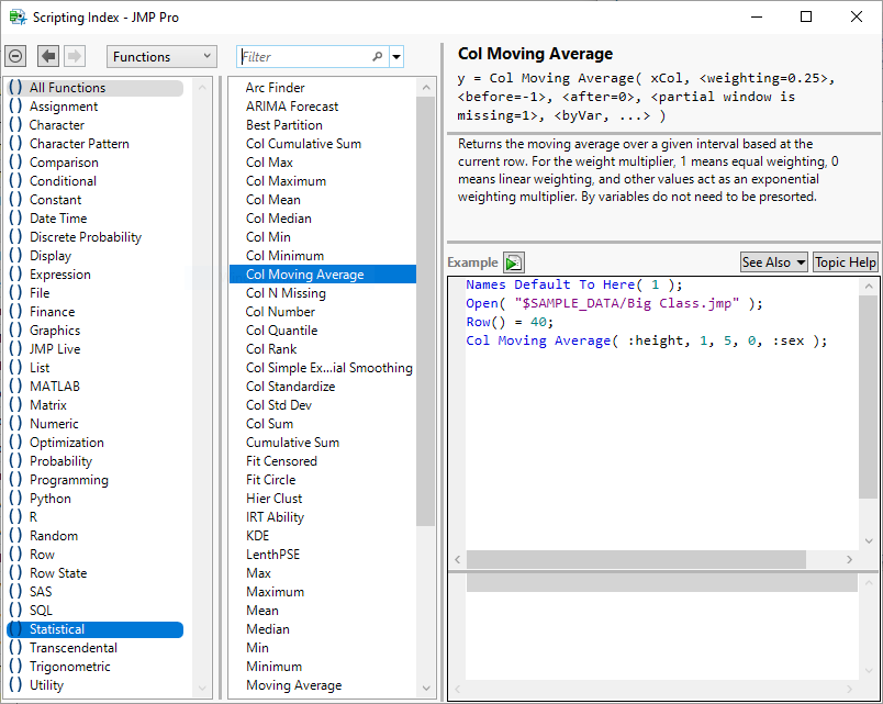

Re: Moving average and EWMA
See this function in the documentation and Scripting Index:
Ah, sorry I missed that detail.  You can add a Lag formula around the Col Moving Average to accomplish this:
For your example:
New Table( "MA Example",
	Add Rows( 10 ),
	New Column( "Data",
		Numeric,
		"Continuous",
		Format( "Best", 12 ),
		Set Values( [1, 2, 3, 4, 5, 6, 7, 8, 9, 10] )
	New Column( "MA",
		Numeric,
		"Continuous",
		Formula( Lag( Col Moving Average( :Data, 1, 2, 0 ) ) )
Gives the expected result:
