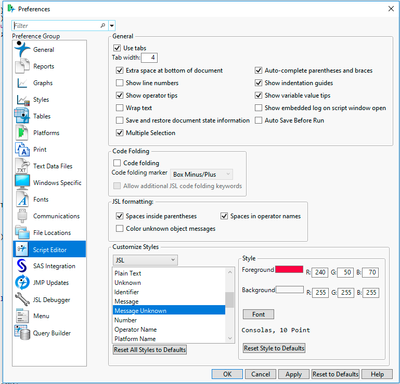

If I am not missing what you are trying to relay, it seems as if you are referring to a message window or an error reported by the Debugger. The flags I am getting are in the code. Based on the default color coding for JSL the keywords in red are either errors or unknown messages. As I do not get an error message when saving the script and it runs without issue, that only possibility left is that the keywords in red are unknown messages.
Jeff_Perkinson
Re: Message Unknown Appearing in Valid JSL Code
Now I understand what you're describing. The picture helps explain that the color coding in the script editor isn't coloring the valid messages correctly. Instead, it's coloring them red as the default preferences proscribe for Messages Unknown.

DaveB
Staff
It looks like you have the "Color unknown object messages" preference turned on. You can find this setting in the "JSL formatting" group box in the Script Editor preference group.  Prior to running the script the albumTable variable has not been assigned so jmp is not aggressive in marking object messages as unknown.  When the script is run, albumTable is set equal to a table and then that table is closed.  At that point jmp can better determine which messages are valid and since a closed table cannot handle a "delete rows" message, the message will then be colored red.  Since evaluating objects and messages can be time consuming, JMP does not recheck every script everytime an variable is changed so you might need to reformat the script or else edit the line with the message to see the color update.
mdawson69
Level IV
That was it. I must have inadvertently enabled “Color unknown object messages” when I was attempting to create a Dark Mode theme.
