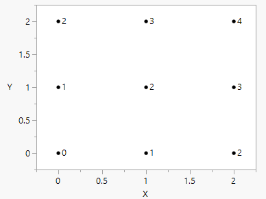

If the polygon layout data table is regular and complete

dtLookup = Data Table( "Layout" );
dtData = Data Table( "Data" );
dtData << New Column( "IV" );
For( i = 1, i <= N Rows( dtData ), i++,
	xVal = dtData:X[i];
	yVal = dtData:Y[i];
	yMin = Col Max( If( dtLookup:Y < yVal, dtLookup:Y, . ) );
	yMax = Col Min( If( dtLookup:Y > yVal, dtLookup:Y, . ) );
	xMin = Col Max( If( dtLookup:X < xVal, dtLookup:X, . ) );
	xMax = Col Min( If( dtLookup:X > xVal, dtLookup:X, . ) );
	botLeft = dtLookup:V[(dtLookup << get rows where( :X == xMin & :Y == yMin ))[1]];
	botRight = dtLookup:V[(dtLookup << get rows where( :X == xMax & :Y == yMin ))[1]];
	topLeft = dtLookup:V[(dtLookup << get rows where( :X == xMin & :Y == yMax ))[1]];
	topRight = dtLookup:V[(dtLookup << get rows where( :X == xMax & :Y == yMax ))[1]];
	dtData:IV[i] = Mean( botLeft, botRight, topLeft, topRight );
