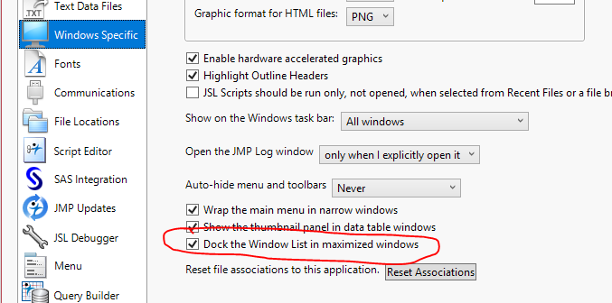

When JMP is run maximized on Windows with this check box on, you get a list on the left that groups reports to the data tables they belong to and the most recent work is on the top. This makes working with the loads of windows that JMP spawns a lot easier.

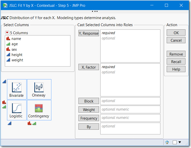

I've attached a script and related file that builds almost all the functionality of the FitYbyX platform. It was written for the book, JSL Companion, Applications of the JMP Scripting Language, 2nd Ed.  This text shows how to build a custom dialog in steps. The attached script is the final step, step 5. See the picture below.  JMP also provides the interactive Application Builder and an example launch application.

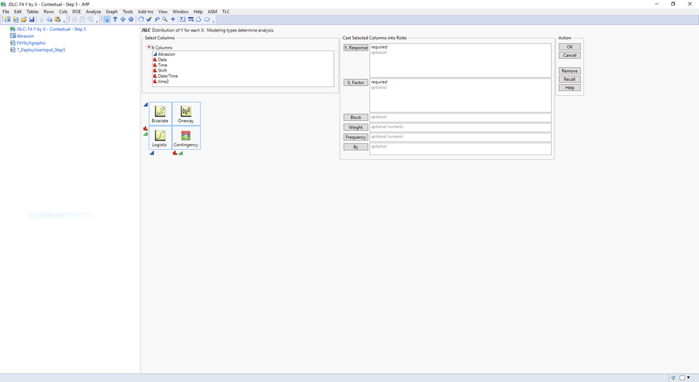

Thanks for your comment, unfortunately that does not look like you think it does. Because I want to make maximum use of screen real estate and have JMP maximized, the non-modal window will also be maximized and that kills the styling:

Good suggestion but no, that apparently gets ignored when JMP is run maximized.

Note the script can control auto stretching.  The script I sent had <<Set AutoStrectching(1,0) which allows stretching in X but not in Y.  By changing the code near line 180 to disallow autostretching in X, <<Set AutoStrectching(0,0), the maximized window will appear as shown in the picture below.  There is no "distortion."   The script was written to emulate the behavior of FitYbyX. Have you tried launching FitYbyX with a maximized window? It has autostretching in X enabled.
