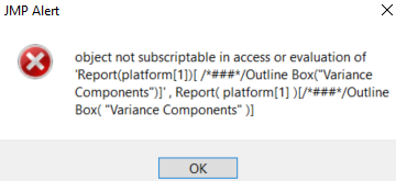

Hi I found what you meant however when I try to run it this error comes up:
Names Default To Here( 1 );
platform = Data Table(
	"table"
) << Variability Chart(
	Y( :measurement ),
	X( :Lot, :Instrument, :Operator, :Site ),
	Model( "Main Effect" ),
	Variance Components( 1 ),
	SendToReport(
		Dispatch(
			{"Variance Components"},
			"CV",
			NumberColBox,
			{Visibility( "Visible" )}
Wait( 0 );
Report( platform[1] )[Outline Box( "Variance Components" )][Table Box( 1 )] <<
Make Combined Data Table;
Report( platform[1] ) << Close Window;
That's the code for reference, firstly it's missing several variability charts, but even when I add them manually the same error pops up. Any ideas?

This fixed it:
platform[1][Outline Box( "Variance Components" )][Table Box( 1 )]<<
