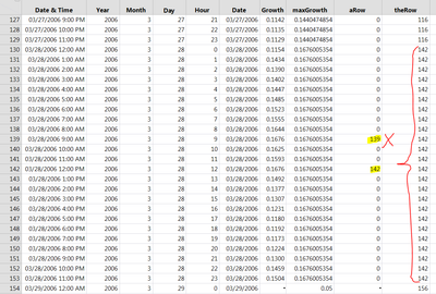

Craige_Hales
Re: Locate latest max value in list for each day
Interesting problem.  If I understand it right, try adding these three formula columns; "theRow" will hold the row with the last maximum value.  (aRow is not the one you want.)
    New Column( "maxGrowth",
        Numeric,
        "Continuous",
        Format( "Best", 12 ),
        Formula( Col Maximum( :Growth, :Date ) )
    New Column( "aRow",
        Numeric,
        "Continuous",
        Formula( (:Growth == :maxGrowth) * Row() )
    New Column( "theRow",
        Numeric,
        "Continuous",
        Formula( Col Maximum( :aRow, :Date ) )
then a summary Data Table( "Growth" ) << Summary( Group( :theRow ) )
Craige
terapin
Level VI
Thanks Craige for your reply,
Unfortunately, what you've proposed doesn't quite work for me.  I'm creating a list of the max values by day.  I will do some additional work with the contents of the list.  My issue is that there are certain days that contain multiple instances of the same value.  I need to create a list then that has just the latest datetime occurrence of the daily max value, not all of them.

// Make an invisible summary table
dt2 = dt << Summary(Group(:Group, :Indicator), Max(:Row));
iVals = Column(dt2, "Indicator") << getValues;
mVals = Column(dt2, "Max(Row)") << getValues;
rn = mVals[Loc(iVals == 1)];
Close(dt2, NoSave);
// Delete the auxiliary columns
dt << deleteColumns({:Row, :Indicator});
ClearLog();
Print(rn);
terapin
Level VI
Ian,
Thanks for your suggestion.  Although Craige's suggestion worked as well, yours did a fantastic job of putting the items I need for additional calculations into lists.  I learned a lot from your (Brady Brady's) suggestion about the absolute power of Associative Arrays.
terapin
Level VI
Craige,
I think I was too quick to dismiss your suggestion.  After playing with your example more I see that it does in fact do what I was hoping for.  Sorry to be so quick in dismissing your suggestion previously. I ended up using Ian's suggestion instead since it put the items I needed into lists.
jerry_cooper
Staff (Retired)
You might try replacing the last line of your code (where you are selecting all the rows in the "rows" matrix) with the following loop. It just compares the Date for each index in rows with the next one and only selects the row if they are not equal. The last line of code selects the last row in "rows" since there is nothing to compare it to. Hope this is what you are after (the assumption is that the table is sorted by Date & Time as in your example).
For( i = 1, i <= N Rows( rows ) - 1, i++,
If( :Date[rows] != :Date[rows[i + 1]],
  dt_growth << Select Rows( rows )
dt_growth << Select Rows( rows );
