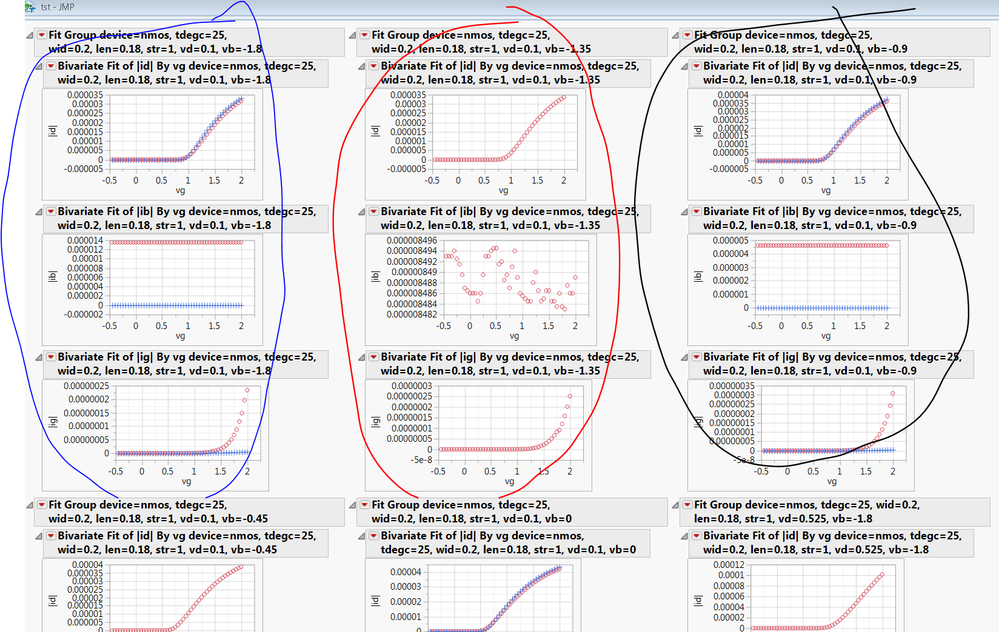

But I would like to have the three dependent variables in a single row rather than in a single column of three graphs. In other words the three plots cirlced in blue in the first row, the three plots circled in red in the second row, and so on. So each 'By' condition has a row with the three plots.
