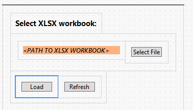

I am Building a JMP application to read in an Excel workbook, for each sheet data in workbook, I have JSL to generate a graph, I also have a JSL to load XLSX to datatables in JMP.
I want to link the JSL scripts to the application builder elements like buttons, could you please help me in understanding where to like the JSL script to button on click functionality?
Eg:
In the above picture, clicking on select file button opens an explorer for user to choose xlsx, then the path is loaded to a variable.
On click of load button I would like to run My JSL corresponding to loading XLSX into datatables.

In the properties panel, you should see an property "Press".  Put the name of a function or expression you want to run here.  Then in the scripts tab, go to the namespace for the module that contains the button and define the function/expression you typed into the Press property for the button.

Thank you for the response, the Word doc on App creation was definitely useful in understanding the app creation process, but I still have my doubt where I have a  standalone JSL script to import the xlsx data and it provides a function call lets say import_xlsx, Is there a way to use Include() statement in the Application builder workspace? so that I can call import_xslx function from On load function of my app namespace.
From your word document, I believe that the initialization of scripts can be done in application namespace. But in my case, I would be sending a path to the import_xlsx function wich is obtained only after user selects the file. so I am kind of confused on where to include the JSL file.
