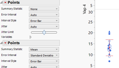

Then I used graph builder to plot. First I got the data points as I labelled in the rows
Then when I added mean and standard deviation by adding another Points (as attached below), the colors of the points were changed

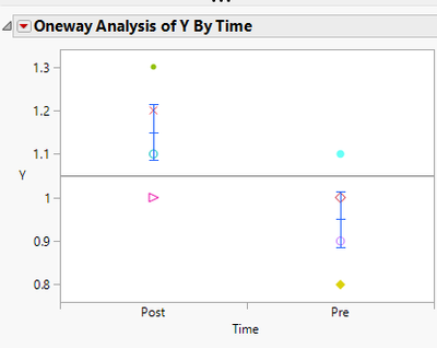

Re: Keep label of individual data points when adding mean and standard deviation
Thanks for the explanation and data. I'm not aware of a way to get the Graph Builder to do this (others might have better insight). However, the Fit Y by X platform can do this. Once you've run the platform, selecting Red Triangle...Display Options...Mean Error Bars gives you what you're looking for. I've attached an updated version of your table with the script saved to the table.
