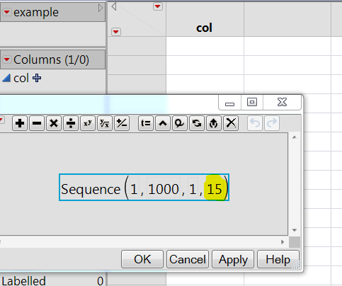

One more approach using the eval(evalexpr( ... expr( x ) ... )) pattern
dt=newtable("example", newcolumn("col"));
blockSize = 15;
eval(evalexpr(col<<set formula(Sequence(1,1000,1,expr(blockSize)))));
Formula with blocksize value substituted for the variableFormula with blocksize value substituted for the variable
The problem all of these solutions are solving is pre-evaluating part of the expression, but not all of it.
EvalExpr() is a function that partially evaluates its argument. The parts that you want evaluated are inside Expr() functions. (Thus the name, EvalExpr.) The result is an expression, which needs to be evaluated to perform the setFormula operation.
