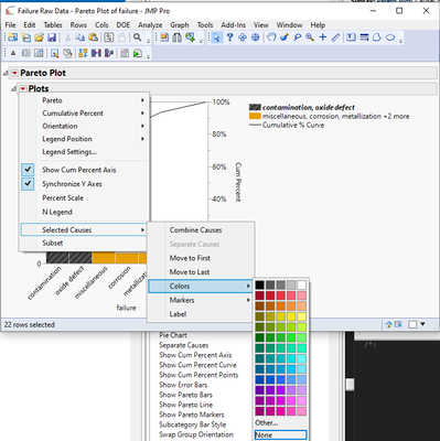

Pareto plot seems to offer option of coloring selected causes
And JMP will give you a script like this (using Failure Raw Data)
Pareto Plot(
	Cause(:failure),
	Cause Colors(
		{{"contamination", "Gray"}, {"oxide defect", "Red"}
	SendToReport(
		Dispatch(
			{"Plots"},
			TextEditBox,
			{Rotate Text("Left"), Set Wrap(277), Set Base Font("Axis Title")}
		Dispatch(
			{"Plots"},
			Text Edit Box(2),
			{Rotate Text("Right"), Set Wrap(277), Set Base Font("Axis Title")}
		Dispatch(
			{"Plots"},
			Text Edit Box(3),
			{Set Wrap(277), Set Base Font("Axis Title")}
So you should be able to color them by building value,color pairs into a list
-Jarmo

Re: JSL how to change the color of a single column in a Pareto plot?
Hi @jthi ,
  Thanks for the info and pointing out that the Pareto platform already has a built-in option for coloring columns. Once I was able to build the nested list correctly, I was able to pass it to the Pareto platform and it works great.
Thanks!,
