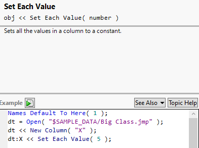

Re: JSL for converting a formula to its results
That message is not helpful in this case. It is used to set every row in the target column to the same constant value.

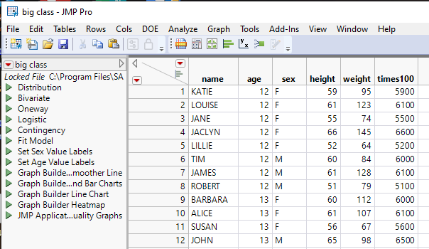

txnelson
Super User
Hee is a simple example using Set Each Value
names default to here(1);
dt=open("$SAMPLE_DATA\big class.jmp");
dt << new column("times100", numeric, continuous, set each value(:height*100));
Jim
That behavior is the intended purpose of the << Set Each Value message as it is documented.
