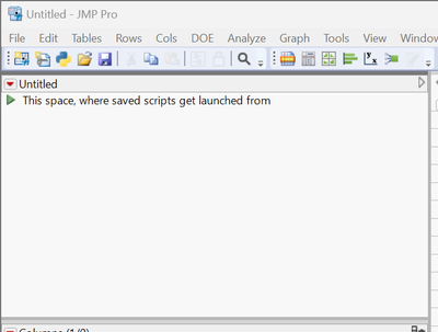

Hello,
Does anyone know the JSL to change the size of the script-launcher window that's embedded in data tables? The area shown in the pic below, the log doesn't show anything when I adjust the size and I can't find the code that references what this area is:

Here is one option
Names Default To Here(1);
w_dt = Get Window(dt);
w_dt[SplitterBox(1)] << Set Width(500);
