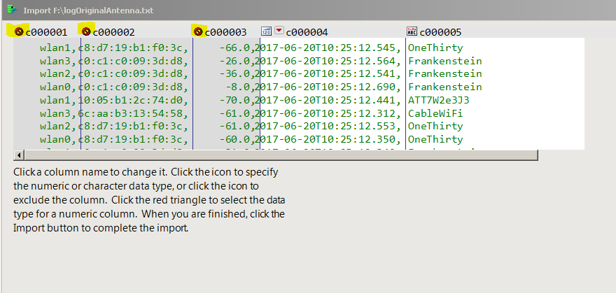

use the text import wizard to mark the unwanted columnsuse the text import wizard to mark the unwanted columns

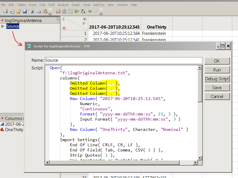

Grab the source script, it has the JSL to omit columnsGrab the source script, it has the JSL to omit columns
(for 1000 omitted columns it might be easier to edit the JSL than exclude with the GUI.)
Now, you can tweak the source script. Below it reads the first 100 lines. It is fast because (1) everything about the columns is specified and (2) it stops after 100 lines. For this data I should have specified Labels(0) and DataStarts(1).
