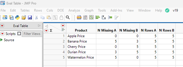

I suggest you create a table that looks like this.
You can then read through the table and build a list of the columns that meet whatever N vs. N Missing for each store you need to delete.
Here is a sample script to create the table

You could use the Tabulate Platform to create the table, but you indicated you have thousands of columns.  I don't believe Tabulate would be the answer in that case, however the above script should handle it.
