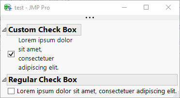

I'm not sure how complex of a solution you are looking for, but I am a big fan of using the MouseBox display to create my own custom displays. Below is a function that allows you to create a custom check box where you can set the width of the text. It uses MouseBox to capture the click while your mouse is over the text to emulate the behavior of a native check box.
Custom Check Box = Function( {text, width},
	H List Box( Align( "center" ),
		Check Box( "" ),
		Mouse Box(
			H List Box(
				Spacer Box( Size( 5, 0 ) ), // for good alignment
				Text Box( text,
					<<Set Width( Max( 25, width - 30 /* check box is typically 25 pixels */ ) )
			<<Set Default Cursor( "Finger" ),
			<<Set Click Enable( 1 ),
			<<Set Click(
				Function({this,clickpt,event},
					{this_chk},
					If( event == "Pressed",
						// if we clicked, invert the selection of the check box
						this_chk = (this << Parent) << Child; // first child of the parent is the Check Box
						this_chk << Set( 1, !(this_chk << Get( 1 ) ) );
longText = "Lorem ipsum dolor sit amet, consectetuer adipiscing elit.";
windowMain = New Window( "test",
	Outline Box("Custom Check Box",
        custom_chk = Custom Check Box( longText, 150 )
    Outline Box("Regular Check Box",
    	Check Box( longText )
// to send messages to the checkbox, subscript using CheckBoxBox(1)
custom_chk[CheckBoxBox(1)] << Set( 1, 1 );
Here's a screenshot of the resulting window:

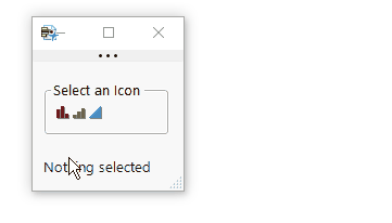

Yep, MouseBox can do all of that. Mouseboxes can also hold data for you to use in a callback function. Below is a small example of using icons as buttons, but you could also use pictures.
Icon Mouse Box = Function( {icon, data},
	MouseBox(
		Icon Box( icon ),
		<<Set User Data( data ),
		<<Set Mark Enable( 1 ),
		<<Set Mark(
			Function( {this},
				// set all of them to be unmarked
				((this << parent) << XPath( "//MouseBox" )) << Set Marked( 0 );
				// set this particular one to be marked
				this << Set Marked( 1 );
				// update something based on this mouse boxes data
				txt << Set Text( Char( this << Get User Data ) );
New Window( "Example",
	V List Box(
		Panel Box( "Select an Icon",
			H List Box(
				Icon Mouse Box( "Nominal", ["type" => "nominal", "someOtherData" => 1] ),
				Icon Mouse Box( "Ordinal", ["type" => "ordinal", "someOtherData" => 2] ),
				Icon Mouse Box( "Continuous", ["type" => "continuous", "someOtherData" => 3] )
		Text Box(), //Spacing
		txt = Text Box( "Nothing selected" ),
		<<Padding( {10, 10, 10, 10} )
Here's an aimated GIF of the above script in action:
