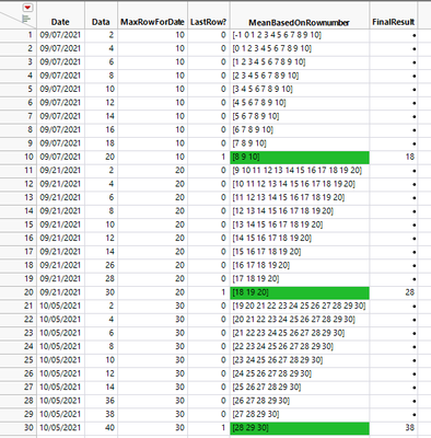

jthi
Re: JSL - Calculate Mean of Last 3 Rows Per Date
I can also open my solution a bit as Col functions can be fairly powerful. Take a look at the explanation when you have time:
  1. Use Col Max(Row(), :Date) to get last row for each date
  2. Check with the if-statement with Row() for last row for date
  3. Use Mean to calculate mean of last three rows for a date. Index(Row() - 2, Col Max(Row(), :Date) creates matrix of row numbers. And then with:Data[Index] we can get values for those row numbers
I have attached datatable in which the formula is split in parts
-Jarmo
