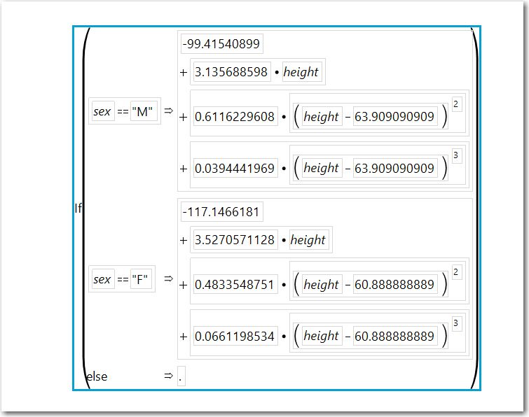

When you specify Save Predicted while using a Where() clause the resulting predicted formula will look like this
This was created with hard-coded where values for the Where() clause. If you look at the titles on each of your Bivariate windows it states:
Where( :c_type == "Cdg" & :process == ProcessArray[n] )
JMP will calculate the splines correctly however, it does not substitute the value of ProcessArray[n].
