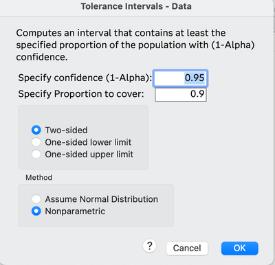

Look into Tolerance Intervals.  There is a non-parametric option you can use.  Available in Distribution.

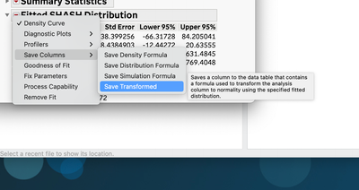

Also, you can fit the SHASH distribution to the data, then save the transformed values to the data table, that transform the data to look like a normal distribution.  You could then calculate tolerance limits on that transformed data and do the backwards transformation to the original scale of the data.

Re: JMP offers specification proposal?
There is a SHASHInv( ) function you can use in a table column or a JMP script to do the back transformation.
