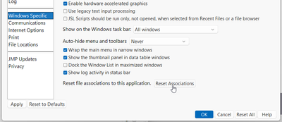

Windows PC?
go to preferences / Windows specific and click on Reset Associations.

Windows PC?

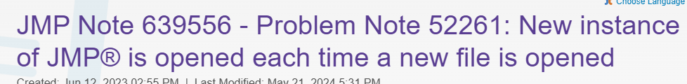

this issue often comes with another issue:
The function in the preference might fix the issue. If not, try this 2-step-approach:
https://community.jmp.com/t5/Discussions/New-instance-of-JMP-is-opened-each-time-a-new-file-is-opene...

I have gotten so used to the "bugged" icons that I don't really bother with them that much anymore but maybe these steps, JMP Note 639556 - Problem Note 52261: New instance of JMP® is opened each time a new file is opened , could help also with the icons as both might be related to file association issues.
-Jarmo
