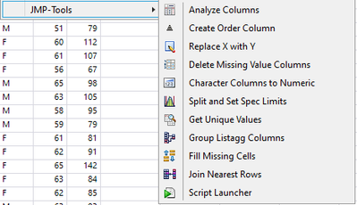

Most of the Add-ins will be added to Add-Ins menu under JMP-Tools:

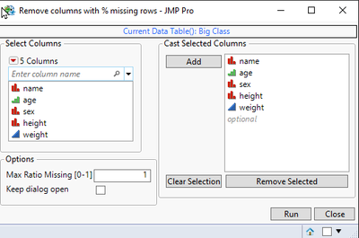

4. Delete Missing Value Columns (delete-missing-value-columns (github.com)
Tool allows user to easily delete multiple columns which have more than specified amount (threshold) of missing values.

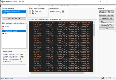

6. Get Unique Values Get Unique Values (get-unique-values (github.com))
Purpose of the tool is to provide user-interface with unique values listed from selected column (nominal, ordinal) in different formats from selected datatable. From this list user can either directly copy-paste values to clipboard or use specific buttons for copying.
Tool also provides an option to paste values directly to the box and get the values in different formats. This is handy when you copy paste values from excel for example. You can also format values from clipboard directly to SQL list.

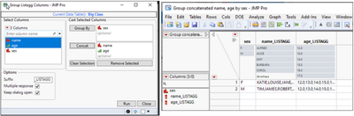

7. Group Listagg Columns Group Listagg Columns (group-listagg-columns (github.com))
Purpose of this addin is to provide a way for user to create new table with a column(s) of grouped values in similar manner as SQL's listagg. In best case this option would be in JMP's Summary and Split platforms as from time to time I would like to keep some values even if I split or aggregate with Summary.
I have created wish list items for both of those Allow Split to create Multiple Response columns andAdd Listagg/Concatenate/GROUP_CONCAT to Summary platform table.

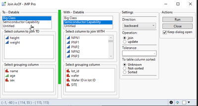

8. Join Nearest Rows Join Nearest Rows - Join tables by using continuous columns and nearest values (join-nearest-rows (github.com))
Join two datatables with continuous column. Can do join backwards, forwards, nearest/closest. Supports using tolerance / max distance for join and usage of grouping column. Data doesn't have to be sorted but it does speed up the tool execution. Inspiration partially from Python Pandas - Merge Asof
I have created Wish List item which is partially linked to this Add fuzzy join / asof merge / join by columns which do not have exact matches

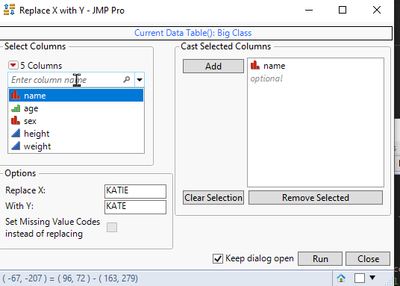

10. Replace X with Y (replace-x-with-y (github.com))
Replaces full matches with other value in selected columns.

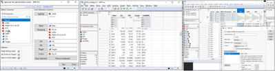

11. Split and Set Spec Limits Split and Set Spec Limits (split-and-set-spec-limits (github.com))
Purpose of this tool is to let JMP users split long (stacked) data and set specification limits directly from the original data if data is in correct format.

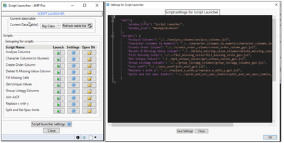

12. Script Launcher (script-launcher (github.com))
Tool to provide quick-access to user defined scripts (pre-configured for jthi-jmp-tools). Provides also access to launching scripts, modifying their settings.json file and opening the directory. Also allows changing current datatable.
Strongy suggested to add as shortcut with easy access, for example mine is Ctrl+Shift+Z. If the script is already open, launching it again will bring it to front.

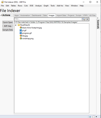

13. File Indexer (file-indexer (github.com) )
This is still very much work in progress but the idea is to provide file listing of the user specified directories and allow opening files/directories.
