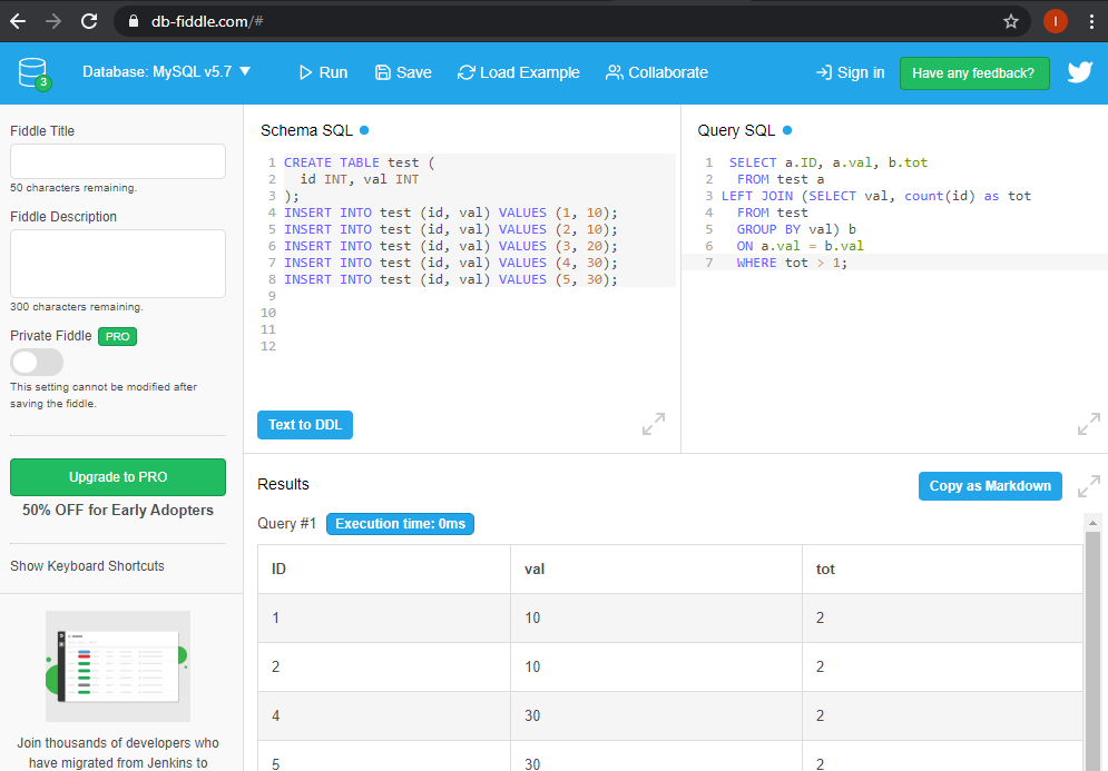

You could test this in db-fiddle using this in the schema:
CREATE TABLE test (
id INT, val INT
INSERT INTO test (id, val) VALUES (1, 10);
INSERT INTO test (id, val) VALUES (2, 10);
INSERT INTO test (id, val) VALUES (3, 20);
INSERT INTO test (id, val) VALUES (4, 30);
INSERT INTO test (id, val) VALUES (5, 30);
and this in the select:
 SELECT a.ID, a.val, b.tot
  FROM test a
LEFT JOIN (SELECT val, count(id) as tot
  FROM test
  GROUP BY val) b
  ON a.val = b.val
  WHERE tot > 1;
which should look something like this:

Thank you @ih . It helps a lot. So there is no "hidden" feature in JMP Query Builder that can accomplish "HAVING" condition directly, which is equivalent to "Filter" or "Order" button. I ran the test table you attached in this thread. Yes I could get the same query result as what you showed. I summarized 3 options in JMP to do this "HAVING" feature: 1) Using the way as @ih mentioned, run the custom query in JMP Query Builder, note that in this way no "HAVING" keyword in the query script.  2) Run the custom query, with HAVING  keyword in the script. It works for me. The custom query looks like this:
