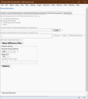

Although I have specified the FDR p-value adjustment, the volcano plots still graph the unadjusted p values on the y-axis. Speaking of volcano plots, how is the horizontal line determined? This value seems to fluctuate between experiments, but I cannot find any indication of what it represents.

Hi @LouisAltamura ,
The un-adjusted -log10(p-values) are plotted on the y-axis of the volcano plot. The horizontal line drawn is the adjusted (in this case FDR adjusted) p-value cutoff defined in the Basic RNA-Seq Workflow dialog (see Multiple Testing section in the figure below). This cutoff is what is used to filter the transcripts so any transcript that has a raw -log10(p-value) greater or equal to this FDR adjusted cutoff is kept and the rest are filtered out.

Re: JMP Genomics - P-value criteria for Basic RNA-Seq Workflow
Hi @LouisAltamura ,
