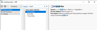

The function "Scroll Window()" is not available in JMP17.  It's not in the scripting index.

Change the browser to search Display Boxes instead of Functions.
