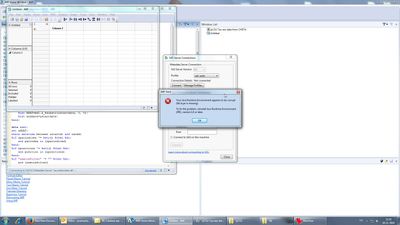

JMP 11 was recently installed for me on my business computer by IT department. It looks like during their installation no Java was installed, as I could find it anywhere. I looked on the SAS website, but could only find an information that SAS 9.3 supports Java 7u15. I couldn't find any confirmed info about Java version for JMP, so installed 7u15 (x86 version). Now when I try to connect to metadata server 7525_capture_002_10112014_111046.jpg
I keep getting the error message like above.
What Java version should I install?

Hey, prmiszkiewicz,
Are you running 32-bit or 64-bit JMP?  If JMP is 32-bit, you need the x86 version of the JRE.  If JMP is 64-bit, you need the x64 version of the JRE.
With early JRE 7 installs, we saw a number of instances of this JRE corruption you are seeing.  To confirm your JRE is corrupt, you can go to a command prompt and type:
java -version
If your JRE is corrupt, you will not get a valid response.
I would suggest uninstalling the JRE you have and then installing the *latest* update of JRE 7, which looks like 7u71. We have not seen the JRE corruption with later updates of JRE 7, plus there are many important Java security updates that have taken place since Java 7u15.
Please let us know how it goes.
Thanks,
Eric

Hi Eric,
thanks for the answer.
So my problem was that I had x86 Java and x64 JMP. Actually IT department told me to only use Java x86, but seems that they were wrong
I installed an older version (u15) and not the latest one earlier, because I couldn't find a specific information about JMP Java compatibility, but found this about SAS 9.3: SAS 9.3 Support for Java Runtime Environments
Then I thought that maybe JMP also supports Java only up to a certain update. Now I have the latest version of x64 Java and everything is working fine.
