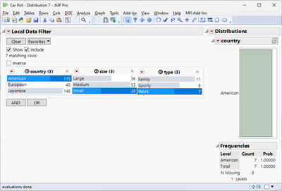

Also like I said in my earlier response, you can tinker around with the display boxes to possibly get some sort of horizontal filter
Names Default To Here(1);
colcount = 3;
dt = Open("$SAMPLE_DATA/Car Poll.jmp");
dist = dt << Distribution(
	Nominal Distribution(Column(:country)),
	Local Data Filter(
		Conditional,
		Add Filter(
			columns(:country, :size, :type),
			Display(:country, N Items(3), "List Display"),
			Display(:size, N Items(3), "List Display"),
			Display(:type, N Items(3), "List Display")
ldf_ob = (Report(dist) << Top Parent)[Outline Box("Local Data Filter")];
lub = ldf_ob[LineupBox(2)];
lub << N Col(colcount);
For(i = 1, i <= colcount, i++,
	lub << Prepend(Spacer Box(Size(200, 0)));
Write();
-Jarmo

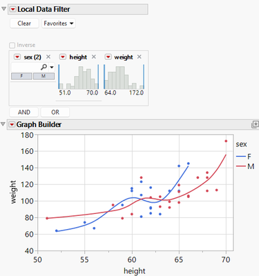

A slightly different approach:
Names Default to Here(1);
Graph Builder(
	Size( 437, 787 ),
	Graph Spacing( 4 ),
	Variables( X( :height ), Y( :weight ), Overlay( :sex ) ),
	Elements( Points( X, Y, Legend( 1 ) ), Smoother( X, Y, Legend( 2 ) ) ),
	Local Data Filter(
		Add Filter(
			columns( :sex, :height, :weight  )
Current Report()["Local Data Filter", List Box( 6 )] << set Horizontal( 1 );
Current Report()[ List Box( 4 )] << set Horizontal( 0 );
OddsDeer284888

Level XIII
Re: Is it possible to arrange Data Filter/Local Data Filter horizontally? (Change UI)
Every list Box has the Horizontal(0/1) flag.
Just change the flag and you can change every vertical List of display objects into a horizontal one.
here is an example for a pure data filter with horizontal mode (don't know if this is useful)
dt = Open( "$SAMPLE_DATA/Big Class Families.jmp" );
win = new window("test", dt << data Filter(
		Add Filter(
		columns( :height, :countries visited, :family cars )
win["Data Filter",ListBox(7)] << set horizontal(1)
What are you trying to do? What conditions? In which order should conditions apply? Do they have to apply in order or can some be skipped? Can you make modifications to the main table (new columns/selections)? When do the filters apply (immediately/on button press)? << Select Where with restrict is most likely one quite simple option
Local Data Filter can use Combo Box (or similar selector)
colcount = 3;
	Local Data Filter(
		Conditional,
		Add Filter(
			Display(:country, N Items(3), "Single Category Display"),
			Display(:size, N Items(3), "Single Category Display"),
			Display(:type, N Items(3), "Single Category Display")
Write();
-Jarmo
