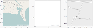

I have been trying to use OpenStreetMap mapping in a graph of sample locations in JMP Pro 15 - something I have done many time before.
However, when trying today, although the "© OpenStreetMap contributors" watermark appears at the bottom of the plot, no map is drawn. My latitude and longitude columns are in the correct format. If I "zoom out" by changing the x-axis scale, then the map is drawn when I get far enough out, but this is way less than "street level" detail, and there has been much higher detail available in Denmark previously (See attached screenshots).

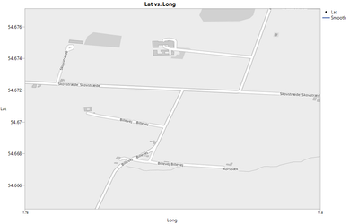

I am not sure why this might have changed, but one option might be to use a different web map service, for example this one:
https://www.terrestris.de/en/openstreetmap-wms/
In the 'Set Background Map' dialog, select 'Web Map Service' and enter this:
URL: https://ows.terrestris.de/osm-gray/service?
Layer: OSM-WMS
Should give this level of detail in graph builder:

Re: Is OpenStreetMap for street-level background maps working?
Layer: OSM-WMS
Thanks @ih that works, and it is nice to have the grey background - but it would be good to have the built-in mapping service working.

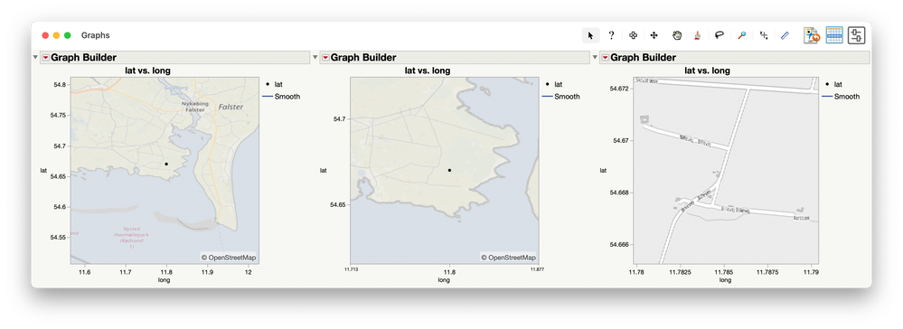

Thanks for looking into this, but unfortunately the maps are still (or again?) not working.  Here the two charts on the left use the JMP map service.  The middle one (slightly smaller region) is blank; I expected it to return results even when 'zoomed in' as far as the case on the right.
To reproduce:
View more...
Names default to here(1);
dt = New Table( "Coordinates",
	Add Rows( 1 ),
	New Column( "lat",
		Numeric,
		"Continuous",
		Format( "Best", 12 ),
		Set Values( [54.67] )
	New Column( "long",
		Numeric,
		"Continuous",
		Set Values( [11.8] )
New Window("Graphs",
	H List Box(
		dt << Graph Builder(
			Size( 400, 400 ),
			Show Control Panel( 0 ),
			Variables( X( :long ), Y( :lat ) ),
			Elements( Points( X, Y, Legend( 4 ) ), Smoother( X, Y, Legend( 5 ) ) ),
			SendToReport(
				Dispatch(
					"long",
					ScaleBox,
					{Scale( "Geodesic" ), Format( "Best", 12 ), Min( 11.5647902766448 ),
					Max( 12.0259891048949 ), Inc( 0.1 ), Minor Ticks( 0 )}
				Dispatch(
					"lat",
					ScaleBox,
					{Scale( "Geodesic" ), Format( "Best", 12 ), Min( 54.4690510216314 ),
					Max( 54.8504643985809 ), Inc( 0.05 ), Minor Ticks( 0 )}
				Dispatch(
					"Graph Builder",
					FrameBox,
					{Background Map( Images( "Street Map Service" ) ), Grid Line Order( 2 ),
					Reference Line Order( 3 )}
			Size( 400, 400 ),
			SendToReport(
				Dispatch(
					"long",
					ScaleBox,
					{Scale( "Geodesic" ), Format( "Best", 12 ), Min( 11.7134986930303 ),
					Max( 11.8772806885094 ), Inc( 0.1 ), Minor Ticks( 0 )}
				Dispatch(
					"lat",
					ScaleBox,
					{Scale( "Geodesic" ), Format( "Best", 12 ), Min( 54.5890610200553 ),
					Max( 54.7509161685288 ), Inc( 0.05 ), Minor Ticks( 0 )}
				Dispatch(
					"Graph Builder",
					FrameBox,
			Size( 400, 400 ),
			SendToReport(
				Dispatch(
					"long",
					ScaleBox,
					{Scale( "Geodesic" ), Format( "Best", 12 ), Min( 11.7797994052467 ),
					Max( 11.7904094848223 ), Inc( 0.0025 ), Minor Ticks( 0 )}
				Dispatch(
					"lat",
					ScaleBox,
					{Scale( "Geodesic" ), Format( "Best", 12 ), Min( 54.664777984559 ),
					Max( 54.6729172236855 ), Inc( 0.002 ), Minor Ticks( 0 )}
				Dispatch(
					"Graph Builder",
					FrameBox,
					{Background Map(
						Images(
							"Web Map Service",
							"https://ows.terrestris.de/osm-gray/service?",
							"OSM-WMS"
					), Grid Line Order( 2 ), Reference Line Order( 3 )}
