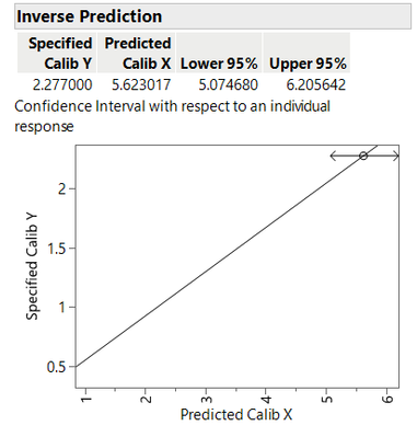

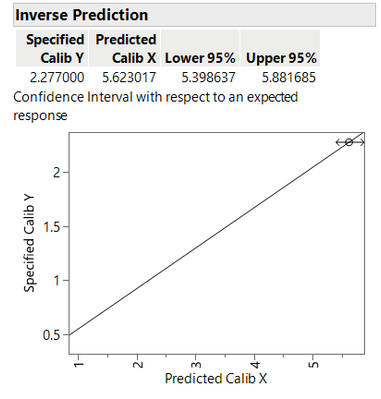

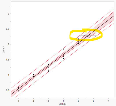

I think the middle ground is achievable. But let me illustrate how the inverse prediction intervals for an individual response and the expected response are obtained.
The following screenshot is obtained by copying the contents of two inverse prediction plots, and pasting into the fitted curve plot.
Look at how the ends of arrows touch the confidence interval bands and prediction interval bands.
So, the inverse prediction "uncertainty interval" is obtained by finding the intersections of the "y" value and desired "uncertainty bands".

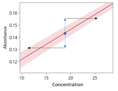

Now, look at your middle ground. What is the definition of the "uncertainty bands" of your middle ground. It should be somewhere between the confidence interval bands and prediction interval bands.

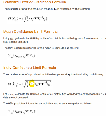

Now you need some math. This is the related math in JMP documentation:
https://www.jmp.com/support/help/en/17.1/index.shtml#page/jmp/statistical-details-for-prediction-and...
I put a screenshot below, and pay attention to the highlighted ONE!
For you middle ground, that should be 1/K, where K is the number of your replicates.

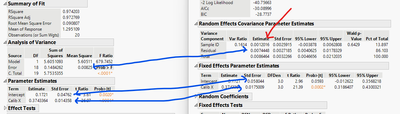

I attach the updated data, with a Fit Mixed script. Then look at the comparisons of results from Least Squares and Mixed:
The blue arrows point to quantities that have different estimates.
The red arrow points to the quantity of estimate of the variance of a single new "y".
Your "middle ground" is still achievable, but the complexity just went up.

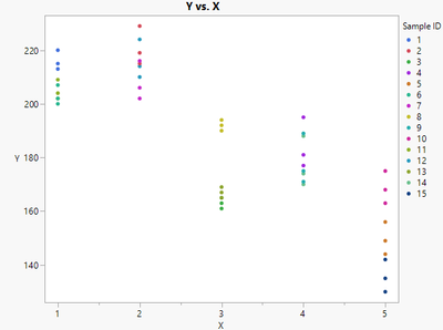

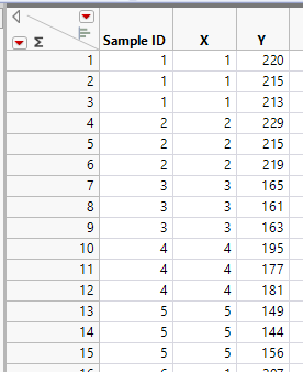

I think I am on the path of better understanding about this. I attach a simulated data.
It looks like this. It has 15 distinct Sample ID, which means there are 15 distinct entities that you measure. X is where you measure. There are 5 levels, 1 through 5. And Y is the measurement. Each entity has 3 measurements.
And there is a script in the data table, which produces this plot
You would like to fit a line, and you are interested in the confidence interval of the inverse prediction using the fitted line. Am I understanding correctly?

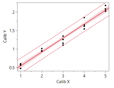

Almost- I think JMP already provides a confidence interval based on the error of the fit curve, that's what the typical inverse prediction does, right?
I want to, for a given calibration curve: (shaded is fit, dotted is individual confidences)
Get an estimate of the inverse prediction error when I have sampled a single (non calibration) entity several times.
Currently I can make an inverse prediction with respect to an individual response (which I assume is a single measurement)
Or with respect to an expected response, which I believe assumed your measurement is "correct" and only accounts for the uncertainty in the calibration.
I'd like to find the middle ground, where I can specify an average response and variance for a sample group of n = 3, or any other replicate
Alternatively, is it possible (or even correct?) to combine the three individual estimates somehow?
