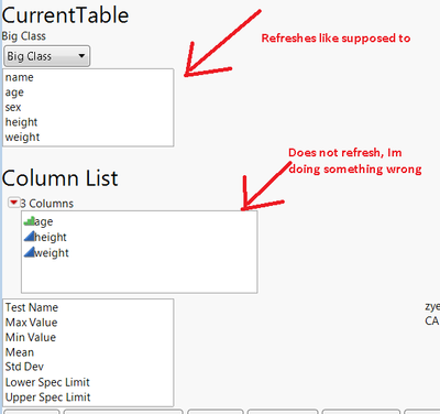

Is there a way to script this following data table list select part into a jsl script?
As of now I have a script done, but only on one data table at a time, is there a function that I can call to make a data table list selector like the picture that I attached above, and upon selection, I can have my current data table updated accordingly? My not-so-flexible script now looks like this
I want to achieve this
Any help would be greatly appreciated!

zhouye0
Level II
Re: Interactive Data Table selector
Hi PMroz,
That works excellent for me, I integrated it into my script and realized that I mis-used a word up there, I was using a Filter Col Selector instead of a col list box, I see your way of doing it is setting and updating the new set of columns from the table based on the selected data table, and the part that refreshes it is when you call
columns_listbox = listbox(col_list);
to display the newly updated table. So I tried to replicate it for the "filter col selector".
1) I modified a bit of your code so that it doesnt appear in a new window and goes to my original window
2) I modified the Filter Col Selector to the "SelectedIndex" variable and call it below in hopes that it would update, but obviously I'm doing it wrong. Do you know the right way to refresh the Filter Col Selector like how you did for the Col List Box? I'd like to apply your working method for the Col List Box to the Filter Col Selector
This is my code for the Filter Col Selector
       param = Filter Col Selector(data table(selectedIndex),
              all,
              width( 250 ),
              colname = param << get selected();
              colStatInfo(colname[1]);
              list << inval;
              list << updateWindow;
              list << reshow;
              param << nominal( 0 );
              //param << Name contains( " " );
