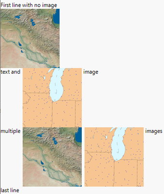

I have a JSON which I get with GET request. The JSON contains two keys, text and images. images has list of objects with name of image and then the image.
In text "¤imagename|img¤" parts are to be replaced with "imagename" image found from images. Below is an example in associative array format
aa = Associative Array();
aa["text"] = "First line with no image
¤tile|img¤
text and ¤windmap|img¤ image
multiple ¤tile|img¤ ¤windmap|img¤ images
last line";
aa["images"] = Associative Array();
aa["images"]["tile"] = New Image("$SAMPLE_IMAGES/tile.jpg");
aa["images"]["windmap"] = New Image("$SAMPLE_IMAGES/windmap.png");
In the original application, the text has images embedded within the text, so it looks something like this:
So the question is: how to build this with JSL? I have written recursive function to do this (below), but I'm looking for other ideas / to provide a challenge to other scripters.
My current solution (which works good enough for now):

My first instinct is to do this:
Names Default To Here(1);
// example associative array
¤tile|img¤
last line";
for each({imgn}, aa["images"]<<get keys, aa["images"][imgn] << Set Size({128,128}));
nw = New Window("test", vlb = v list box() );
hlb = {};
lines = words( aa["text"], "\!N" );
for each({line, l}, lines,
parts = words( line, "¤" );
hlb[l] = h list box();
for each ({p}, parts,
cur_img = Regex(p, "^([^ ]+)\|img$", "\1");
if( Is Missing(cur_img),
insert into(hlb[l], text box(p) ),
hlb[l] << Append( aa["images"][cur_img] );
insert into(vlb, hlb[l])
