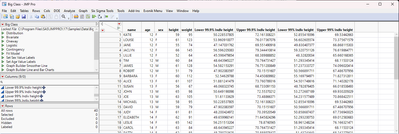

  Not sure why you're having an issue. I tried it with the Big Class.jmp file, and it works just fine.
  I first did a fit y by x of height and weight, fit a line to it, then changed alpha, then saved the confidence indiv limit formula, and did that for both alpha = 0.001 and 0.01, and it worked just fine. The column formulas are different, and the smaller alpha has a wider CI, as expected.
  Are you sure you did the order of operations correctly so that when you saved the Confidence Indiv Limit Formula it saved the correct formula?
  Not sure what's going wrong, but give it a try with the Big Class.jmp file first and make sure that what you're expecting happens (no bug) or something different (bug) happens.
