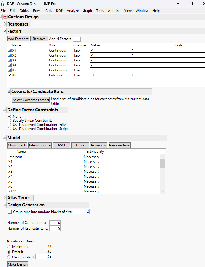

I-optimal custom DOE RSM design with continuous and categorical factors - centre points not balanced?
Hi, I want to create an I-optimal custom DOE with 5 continuous factors and one categorical factor (with 2 levels). I also want to have 4 centre points which I specify on set-up. I also choose RSM for my model as I know there is curvature. When JMP creates the design, the centre points are not equally divided across the two categorical levels - one category gets 4 centre points and the other gets 2 centre points. I would manually alter them to be balanced, however, this would result in L1 having two more runs throughout the experiment than L2. Is there anything that I can do to ensure the centre points are balanced across these two levels?

The "quick fix" solution could be to create the design without the centre points (so that levels of the categorical factors are balanced), and manually add the 6 centre points (3 for L1, 3 for L2). You could then randomize your design table by using the Create a Subset Data Table platform with sampling rate of 1, to keep all rows from your design but randomize the order.
Note that if you really need to enforce a balance between your 2 levels of categorical factor, you need to have an even number of total runs (like 32 or 34 in your example). Else JMP will try to find the best trade-off/balance between the repartition of centre points and the "other" points so that all runs are distributed in a "balanced" way across all levels.
