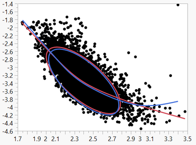

How to zoom fit to density ellipse in Bivariate plot.
without manully adjust the axis it is plotted like this
but this is what I want
is there anyway to calculate the max,min value to use as X,Y axis ?
please help...

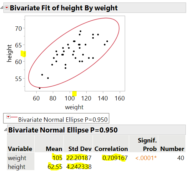

The platform does not have an option to zoom to the ellipse.
The platform does display some stats you might be able to use, but I'm the wrong person to tell you how to get from these numbers...
...to a tight zoom about the ellipse. If it just needs to be good enough, you can probably do it with a couple of experiments. You can write JSL to grab the high-lighted numbers from the report and set the axis range. I think you might not need the correlation, just the two std deviation values, scaled somehow, and added/subtracted from the mean values.
If you want to write some JSL, take a look at Ellipse . It shows how to compute the ellipse.

I forgot to mention that I want this effect as jsl script not by manually clicking.
is there any option ?

I tried to get that Mean Value and then manipulate add/subtract with 3 x Std Dev and set this value to axis Min and Max this trick manage to get me to the desired result.
