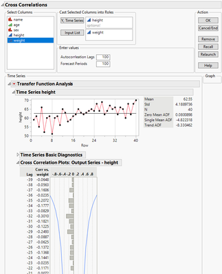

Hi All,
  I have a script where I am testing out the autocorrelation of two columns in a data table. This is done on the Big Clas.jmp file.
  I want to add to this script a panel that also shows the graph of the autocorrelation between the two columns -- specifically, I'm trying to graph the column called Lag and the column called Corr vs weight in the Time Series report shown above.
  I can get those two columns as a list of numbers in a matrix form by using the command <<Get As Matrix to the number column box in the report sub-panel.

  I'd like to be able to send these matrices to Graph Builder to get something like this:
But GB doesn't like that the data is a list of numbers -- it wants the inputs for X() and Y() to be columns. The above example was done by right clicking on the report and selecting Make Into Data Table and then using GB in the normal way. I'd prefer to not have to do that though.
Is there a way to send to GB the data that's in memory instead of as columns? I tried the below code, but it doesn't work.
