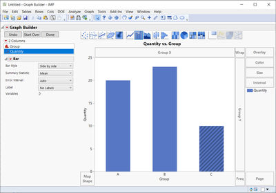

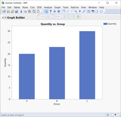

hello, I am new to JMP journal. I have a simple question as below when I start to use journal.
an example data and graph,
ChernoffTurtle7_2-1702610677695.pngChernoffTurtle7_2-1702610677695.pngChernoffTurtle7_3-1702610727799.pngChernoffTurtle7_3-1702610727799.png
Next, the data is changed, and I want this graph in journal could be changed accordingly. How to make it happen in a easy way?

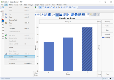

The only way I know to do this, is to run the platform from within the Journal window
Names Default To Here( 1 );
New Window( "active journal",
	<<journal,
	Graph Builder(
		Variables( X( :Group ), Y( :Quantity ) ),
		Elements( Bar( X, Y, Legend( 4 ) ) )
