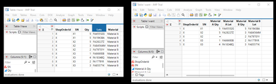

How can I convert left side table to looks like to right side one.

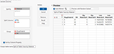

Below is the closest I was able to get with Split function.

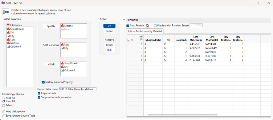

Create a new column with the following formula
Col Cumulative Sum( 1, :ShopOrderId, :SN, :Material )
Then Split using the following setup
Then after the split, delete the formula column, in my example, delete Column 6
