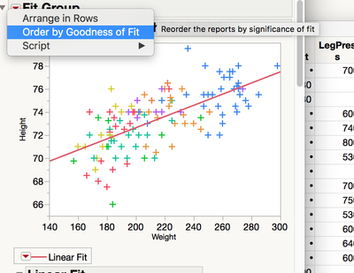

Are you familiar with the option to "Order by Goodness of Fit".  Using this on sample data such as Football.jmp has the best R-squared at the top and the worst at the bottom.
Here's the sample script to take a look.
dt = Open( "$SAMPLE_DATA/Football.jmp" );
dt << Fit Group(
     Bivariate( Y( :Height ), X( :Weight ), Fit Line ),
     Bivariate( Y( :Height ), X( :LegPress ), Fit Line ),
     Bivariate( Y( :Height ), X( :Neck ), Fit Line ),
     Bivariate( Y( :Height ), X( :Squat ), Fit Line ),
     Bivariate( Y( :Height ), X( :Fat ), Fit Line ),
     Bivariate( Y( :Height ), X( :Bench ), Fit Line ),
     Bivariate( Y( :Height ), X( :Speed ), Fit Line ),
     <<{Arrange in Rows( 1 ), Order by Goodness of Fit},

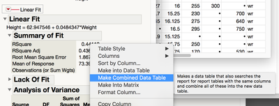

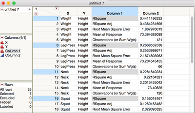

As you have 100's of X's you may want to even turn things into a tabular format using the make combined data table.
And then you can select the R-Squared value:
