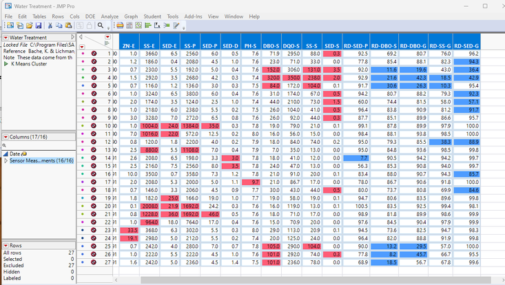

Hi JMP team,
I plan to do automated outlier analysis using Explore Outliers. The goal of this automation is to get a neat, easy to view table to show only row item and column item with outlier(This require to filter out those non-outlier column and row). Take Water Treatment as example below to rid row item without outlier.
Names Default To Here( 1 );
dt = Open( "$SAMPLE_DATA/Water Treatment.jmp" );
obj = dt << Explore Outliers(
	Y( dt << Get Column Group( "Sensor Measurements" ) )
obj << Show only columns with outliers(1);
obj << Tail Quantile( 0.1 );
obj << Q(3);
obj << Quantile Range Outliers;
obj << ColorCells(dt << Get Column Group( "Sensor Measurements" ));
obj << SelectRows(dt << Get Column Group( "Sensor Measurements" ));
obj << ExcludeRows(dt << Get Column Group( "Sensor Measurements" ));
dt << select where( Excluded(Row State()) != 1 );
dt << Delete rows;
Question how to filter out non-outlier column using jsl code?

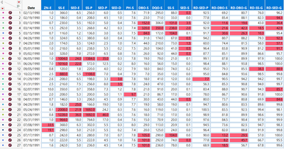

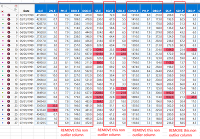

Re: How to select column for Quantile Range Outlier using jsl
Hi Jim,
Thanks for the code.
I tried the code above, my JMP15 did not support For Each(). I make some changes on For Each to For loop.
But still unable delete the non-outlier column.
obj = dt << Explore Outliers( Y( dt << Get Column Group( "Sensor Measurements" ) ) );
obj << Show only columns with outliers( 1 );
obj << Q( 3 );
obj << ColorCells( dt << Get Column Group( "Sensor Measurements" ) );
obj << SelectRows( dt << Get Column Group( "Sensor Measurements" ) );
obj << ExcludeRows( dt << Get Column Group( "Sensor Measurements" ) );
dt << select where( Excluded( Row State() ) != 1 );
dt << Delete rows;
allEvaluatedList = Report( obj )["Quantile Range Outliers", String Col Box( "Column" )] << get;
colList = Report( obj )["Quantile Range Outliers", String Col Box( "Column" )] << get;
For( i=1, i <= N Items(allEvaluatedList), i++, col=allEvaluatedList[i];
	If( Contains( colList, col ) == 0 ,
		dt << delete columns( col )

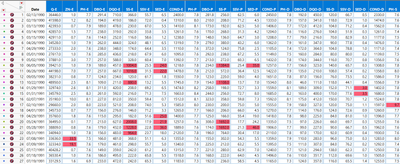

Non outlier column still present in the data table below.
Am I missing something?

XHLow
Level II
Great!! It works now.
Thanks Jim.
