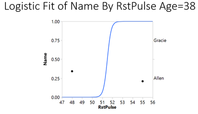

Hello users,
I am trying to save a journal as powerpoint. I would like to save 2 graphs per powerpoint slide instead of just one.
Right now I get 1 graph per slide. I want 2 graphs per slide.
How do I go about doing that using JSL?
My JSL script is:
Names Default To Here( 1 );
dt = Open( "$SAMPLE_DATA/Fitness.jmp" );
obj = Logistic( Y( :Name ), X( :RstPulse ), By( :Age) );
obj << journal;
Current Journal() << Save Presentation("fitness_logistic.pptx");
Thanks.
