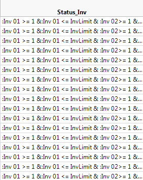

I wish to them use the condition I built as an expression and define a condition . The problem though is in its current form , since the "Stmt" I built is enveloped in double quotes, it is being evaluated as a string and the statement I built is being populated into the new column.
If someone can show me a simple way to replace double quotes in a string and get this to work , I would appreciate the help .

Eval( Parse( Eval Insert( will get you out of trouble when you are really stuck but should be a last resort as the code is hard to debug.
Basically you are inserting your string as text into the desired JSL and than evaluating the JSL. The ^^ tells the Insert Command where to work.
Eval( Parse( Eval Insert("\[ dt_Inp << New Column("Status_Inv",Numeric,Continuous,Formula(^Stmt^)); ]\" ) ) );
This is called dynamic JSL which can be very powerful.
