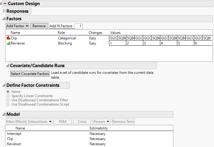

I used a Custom Design. I defined a categorical factor Clip with 12 levels. I created a fixed blocking factor Reviewer with 6 runs per block. (You can assign the reviewer ID with the Value Labels column property.) The definitions look like this:

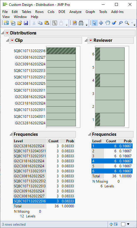

I chose 36 runs to achieve all combinations with random assignment using D-optimality. I checked and the design is balanced, which ensures that every reviewer gets 6 clips and every clip gets 3 reviews.
