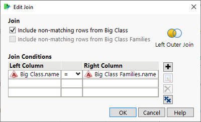

The gray-out "option" can only be activated for Database queries:
When you want to build a query from JMP data tables:
the option is always disabled:  Supported Join types for Table > JMP Query Builder
If you need this option you can ask a community manager to reactivate this wish:
Add right and full outer joins to JMP Query Builder  ... and vote for it.
